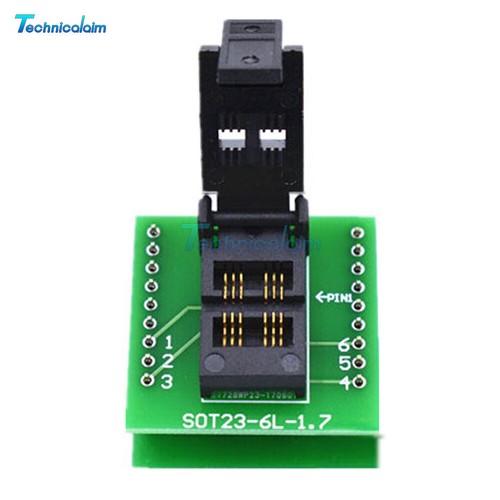

so last night I made an attempt to test these tiny fellas (without soldering), and tried to use a SOT-23 adaptor board socketed to the RG Keen JFET matcher.
after a while of persistence, I was able to get readings, but honestly this was just stupid, and painfully difficult to get it to work.
I really don't want to use adaptor boards when there's SOT-23 pads available on the PCB, so my question is - how to test SOT-23 JFETs without soldering them to a board?
is there some sort of a socket available that people are using?
i see two options:
Peak23 SOT23 socket
ebay SOT23 socket
I would greatly appreciate some recommendations

SOT23-6L SOT23 To DIP6 IC Programmer Adapter Chip Test Socket | eBay
Test Socket model: SOT23-6L-1.7 Clamshell. IC Seale: SOT23-6L. IC Spacing: 0.95mm. IC Body size: 1.6mm. IC size with pin: 2.8mm. Am 22.02.22 hat der Verkäufer die folgenden Angaben hinzugefügt hope you could understand.
www.ebay.com.au
