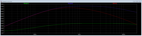

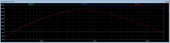

Here are some freq response plots from LTSpice. V(hicut) is the signal at pin 3 of the LEVEL control.
Pure TS setting. BOOST at zero, DRIVE at noon, LO-CUT at 10:00, HI-CUT at 1:00.
Clean Boost. BOOST at noon, DRIVE at zero, LO-CUT and HI-CUT dimed.
Full Tilt. BOOST & DRIVE dimed, LO-CUT & HI-CUT at noon.
