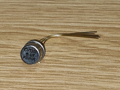

I buy a lot of germaniums from this vendor they're always good the CV7351 is just the military version of it
If you ask I'm sure he'll give you hfe and leakage specs
Here's the CV equivalents in case you're ever looking for germaniums you can't find you'll sometimes get the CV military spec ones

The CV7351 link on eBay is a good option if you aren’t able to measure. I think that in the link to the mods from Chuck you can find the best HFE values
If you go with the Chuck values, you should also go with the Soviet germaniums. They sound just as good as their western counterparts and they cost a fraction of the price.
Mp38A are great, little lower gain. 2n130x and cv7351 are brighter imo. I’m not sure it’s advisable to build this without being able to measure or experiment. At least that’s the fun and essential part for me with fuzz pedals. ;)

Every time I use genuine 2N1308s (or the CV7351) I find them fussy to bias and thinner/brighter sounding than the Russian MP38. The MP38s almost always sound better to me - warmer, fatter, however you like to describe them. And they are generally easier to get working. As well as being way less expensive!
