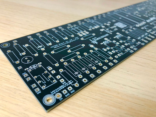

The time has come for the little birdie to fly away from the kit nest and build a big boy amp. After building two Trinity amps kit, an Allen amp kit, two Metro amp kits and the latest SLO30 kit, I really have narrowed down what I want in an amp and decided the Friedman BE-50 would be an ideal amp for me. I love the idea of 50 watts and two channels with a JTM45 style clean and a heavier gain side, this started the search that lead to AA Electronics and the Black Eye 50.
Now armed with PCB, BOM, Schematic and Layout I have realized that I might be a bit over my head. I understand how to buy parts and populate pcbs and the basics of amp building but the part I am struggling with is finding the right transformers and chassis.

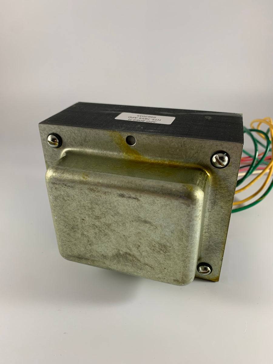

Let us start with the Transformers, the original uses a Heyboer HTS-12037, this is a power transformer with a 14v 2.5 amp accessory tap that powers the relays for the amp switching. I contacted Heyboer and they will not sell me one directly but did send links to this one;
This transformer meets all of the specs except the accessory tap is 5v at 3 amps, will this be enough to meet the requirements for relays?
If not, is there any transformer manufacturers that might make the set I need? I reached out to Andrea of AAelectronics and he has recommended inMADout for a set but they will not respond to any emails….

Looking quickly over the schematic, it looks like the accessory tap you mention powers the relay and V1, 2 and 3 heaters through a voltage regulator and rectifier. So you need a 14V - 2.5+amp for this. You can't use a 5V (you'd rectify the 14V down to 12.6). I don't see how the transformer recommended fits the bill in any way without some pretty tough changes on the components and wiring.
I would suggest to write down what you need from your power transformer and contact custom companies to get a quote. You might be surprised. My custom 1 off transformer for my DL clone came out just under 100€ and it was just as beefy.

I would contact Heyboer again and explain about the 5v vs 14v windings, they may not have caught this when they made their recommendation.
I have had good luck communicating with APD, maybe reach out to them to see if they do actually carry the correct one.
Finally, get with AA Electronics and explain the issue. Maybe they've came across this before and have a quick solution.

Great idea @GAStan when I contacted Heyboer I asked for a specific model number, maybe they have something closer inline to what I need.
Going to reach out to APD and see what they recommend. I have reached out to AA Electronics and he pushed me to go through inMADout and they will not respond.
I think musical power supplies will wind to your specification

I had a quick look at Hammond, their PT won't fit. You might find something somewhere off the shelf but a 100V bias tap is not that common, it's usually 50V, so you'd have to change the bias circuit. But really, a decent transformer company (any size!) can wire you something with 4 secondaries no problem. Get a couple of quote and see from there. I would have given you leads but I am in the EU so that wouldn't make sense for you, sorry.
As Harry mentioned, if you are really averse to drilling, you can 3D model a chassis and send it somewhere to fold/drill. I am fairly sure a Hammond chassis + a step drill bit would be significantly cheaper though, and those are even available through Mouser. As for the "gutter" trick, what you are looking for is a bent to order C-profile aluminum. I would recommend 2mm (I got 3mm and it was unecessarily difficult to work). The Hammond are 1mm and I personnaly find it too thin. My cut to size C-profile 3mm ended up exactly the same price as a 1mm Hammond of the same size...
My transformer rec would be get what's best overall for the core amp, disregard the relay requirements. The Heyboer stuff from APD is priced well, I've had good luck with them. Then for relays, and perhaps DC heaters for your preamp tubes as well, get one of these:
