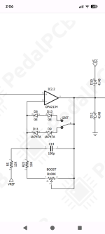

I'd like to reduce the brightness of the boost side of my Fordoble (same as the Arche). I saw @HamishR's thread (https://forum.pedalpcb.com/threads/simple-fordoble-mods.15776/) about a treble snubber at the output of the boost, but I'm hoping to find another way of accomplishing this.
Can I pull one pair of diodes from the "Grit" switch and replace them with a low pass filter? If so, how might I set that up?
Thanks!
