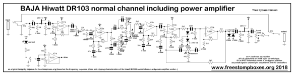

Curious to know if anyone has knocked one of these up. I know there was a brother some time back having difficulty’s. This seems to have been resolved by highering the value of the resistor between Pin 6 and 7 on IC1. I would likely put a 20k trim here.
2SK117s are like rocking horse shit in the uk, would likely sub them out with 2SK209s.
Going to knock up a schematic on Eagle when I am back from my trip.
Any considerations would be appreciated.
