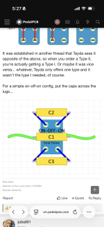

I’m going to build the Bassdude and thinking of some mods that are plexi inspired (but slightly less aggressive) and some which provide a middle ground.
Plan is to install switches on:
- C5 (coupling cap): ~22n, ~10n, 4.7n
- C6 (bright cap): 100pf, ~250pf, ~390pf
- C8 (cathode bypass cap): ~220u, ~5u, 1u
I’ve built 2 C2CE tube pedals and can follow directions but I’m beholden to Google and the forums for any mods... I found a diagram for an on/off/on switch with the capacitors wired onto the switch but there’s a few things I’m not sure about.
1. Whether I need pull down resistors and if so how I wire them (where I connect them and how to ground them).
2. Where I should locate the switches in the enclosure. I thought there might be enough room under the back of the pcb but I’m not sure. Otherwise perhaps up near the jacks.
3. If I add a 330k resistor to ground on R12 (to mimic the load of the second channel / reduce gain which aligns with the amp), how I ground this. And tbh whether this is even worthwhile.
Any help would be greatly appreciated! Also welcome any comments on the mods above or any other experience!
Cheers!
