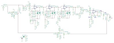

Hello,
I built my own layout using the JHS schematic, and I’ve started testing some mods. I can only use an SPDT switch, so can't do all the mods I potentially could.
- To get more high end, a switch can remove a pair of ceramic caps, changing the original 470pF value to 50pF. For some reason, the second stage is the one that works; leaving off the other two 470pF caps doesn’t do much. Honestly, I hoped for a bit more high end.
- To cut the low end, I added a 47nF cap in parallel with the output cap. It’s totally irrelevant when paired with the original 10uF, but the switch removes the big one, and the 47nF cuts the excess bass.
- Another low-end mod is adding a 220nF cap to the 3.3nF in the tone section. It might seem insane, but with this, the tone pot keeps a lot of bass, even at higher settings.
I’m not sure what I have to do with the 4.7nF cap across the ground. I’ve soldered them, but to see if removing just one will give me more high end, I need to desolder it.
I tried replacing the 4.7uF in the three stages and 47uF caps in the last stage with 100nF caps, and it sounds wonderfully balanced. But that’s a mod I can’t do right now. The output cap mod works fine, though.
I didn’t like the sound when I removed the 10nF cap in the tone section.
I replaced one 1N4148 diode in the first and second stages with a BAT41 diode (I only have two). It seems to reduce the volume and add a bit more distortion. I’ll try other combinations out of curiosity, though.
By the way, regarding the distortion, I find it smoother and less aggressive than the stock Big Muff. Although I soldered the resistors onto the board, I might try some lower values for R5 and R8. I’m not sure about the 470k in the feedback loop, I think the distortion is pretty much maximized as it is. At least at our ears.
Maybe I can see what a pair of 1N4148s diodes as hard clipping does, but someone said it sounds bad.
I don’t want to add extra gain stages.
I tried removing the 4.7uF cap in the first stage. I got just a little bit of distortion, and it sounded a bit duller. The Sustain pot became useless.
If I replace the cap with a smaller one, like 470pF, I get a bit more distortion, slightly more than with no cap at all, but a little brighter sound. The Sustain pot became just a subtle coloring control. With a 2.2nF cap, it became a bit more aggressive and brighter, and the Sustain pot gave more grit.
This is useful if you want a bit of break-up and sparkle, which works more evenly with the guitar's volume control. In some cases, the Tone knob helps to make it more glassy or sparkly.
An 1nF cap could be the right spot.

I tested removing the C4, C7, and C10 4.7nF caps. Almost nothing changes, but removing C7 seems to bring out a bit more high end. I guess i'll put in on switch anyway.
I decided to use a switch for the 4.7uF and 470pF values on C6 to get a sort of smooth overdrive sound.
I soldered all the diodes, because there's nothing I can do with my project, 1N4148 works fine.
I just removed R8 47k to see if I can get more distortion with lower value.
