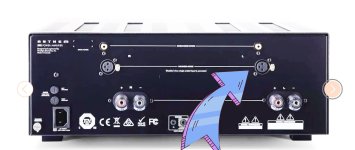

I'm trying to go "amp free" and would LOVE to make it a DIY. 1/4" ins and outs for amp stuff and an XLR or TRS for "driving" the line in. I've build 40-50 pedals and have a HUGE inventory of parts xlr.jpg , to my spouse's never ending delight and amusement. Not. Can anyone think of a solution for me? Thanks guys. What a great community!

I'm trying to go "amp free" and would LOVE to make it a DIY. 1/4" ins and outs for amp stuff and an XLR or TRS for "driving" the line in. I've build 40-50 pedals and have a HUGE inventory of partsView attachment 111545, to my spouse's never ending delight and amusement. Not. Can anyone think of a solution for me? Thanks guys. What a great community!

If you want to go amp free, why show us an amp? 😎 Please detail your actual desired signal chain.
