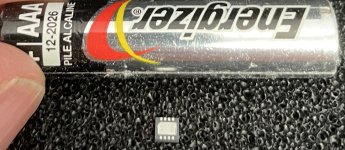

Boy howdy that's a pricy little component.
317 - old school,
3080 - 70-80dB PSRR up to 1.1A, parallel/chainable
3042 - 90dB PSRR but up to 200mA, parallel/chainable
Just be a little careful with the ordering of the packages, these 3042 which should be good for pedals etc but need some PCBs made up:
