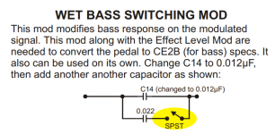

Getting into making my own pedals and a friend asked me if I can building him a chorus. I was going to use the Cepheid Chorus PCB and was wondering if there was any parts I could swap out to make it more suited to bass? Thanks in advance, I'm already enjoying the building process.
