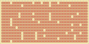

Hi all,
Here's a vero layout for this rock machine. Thanks for sharing the mods to CB!
I checked the voltages in my build and they look good. It also passed the IDSS check that is described in the Boneyard thread. It was a fun and rewarding build! Great sounding overdrive.
All the best!
P.S.: The picture with the cuts is already mirrored for ease of use!
