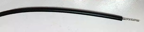

This is how your Hookup wire should look prior to soldering to PCB, Jacks, Footswitch's:
Hey @music6000 Not sure what you're trying to tell me here, could you expand? My wires do look a little burned here though and I need to fix them for sure.
Not sure, but the right ground too ?
Good eye! I think it needs some attention as well. Thanks for spotting it.
