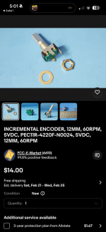

Anyone know a source for part number and or parts for Boss pedals? Specifically I have a RV-500 with a bent TIME encoder and need to replace it. Not worth sending it in ext for a fix. It really looks like this at Tayda is very close except for shaft length (Boss is 17mm vs this but otherwise seems identical. Are encoders vastly different in internals?
Yes. I replaced one last fall. Let me look it up…
This is the one I got, might not be exactly the same though.
https://ebay.us/m/M4XtIU
Thanks - dont think those have the "push switch" like the TIME knob needs - think thats the other 2 pins in the pic
from that I measure its supposed to be a 11mm, 20 detents, 17mm shaft (7 busing/7 flat)
the tayda seems exact except a 'tad' shorter 15mm shaft, 7 bushing 6 flat so it sits 1mm low - which I could prob shim out etc .
