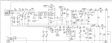

Over the last year I started getting into guitar pedal building and truly enjoy it, but have not been able to find a pedal build that has the exact sound I am looking for. I have built a Kliche, Julia Clone, Face Melter, ADHD, Thermionic Distortion and a Spatialist Reverb. All are brilliant and I cannot choose between them so all of them are on my board.
My absolute favorite overdrive/distortion is the OD channel 1/2 on a MG100DFX.
Would it in any way be possible to isolate that part of the schematic and have a design drawn up and schematic and gerber files made to include the layout with a switch to toggle between OD1/OD2, Gain, Bass, Middle, Treble, Contour and Volume controls? If it would be, what would the costs be and who would be able to provide this service? It won't be commercial, just for me and a few friends but after hearing horror stories about scammers on Fiverr it's safer for me to not go that route. I have a quality schematic that I can send of the MG100DFX as well.

I played around with this a bit, trying to make it a unipolar supply (just +9V) which looked reasonable given the clipping diodes in the main gain stage anyway. (caveat: I have no idea what I'm doing) When I simulated it in kicad I got all kinds of trouble, tho, but I'm not sure how much of that is my limited experience in playing with the simulator. I'll see if I can breadboard something in the next week or so if I get a chance.

@Reconciledheart I did play around with this on the breadboard a bit this weekend for funsies,
with a bipolar supply (+9/-9V). I got as far as the main gain stage, I haven't gotten through the
whole tone stack part yet. I might try it again next week with a unipolar supply + vref
to keep the parts count down but I'm heading out of town for a week so it'll be a bit.
It is clippy asf, almost a square wave coming out of the gain stage, but maybe that's how
it's supposed to sound. (metal!)
One hassle about this is that it has so many controls, any more than 6 controls and it gets harder to fit
in a 125B. (looks like it has Gain, Treble, Mid, Bass, Contour, Volume, and then the OD1/OD2 switch).
Are any of these controls like set-it-and-forget-it, like you always leave it on OD1 or OD2?
If one of the controls stayed internal, it'd be easier to lay out.
(Yeah, could do another footswitch or something for OD1/OD2, or an offset layout, as well...)
I haven't gotten this all breadboarded, but I just yolo'ed a through-hole PCB layout and will order a stack of 'em next time I order from JLCPCB, and see how it works. If it makes any reasonable noises I'll release the gerbers for people to try out.
