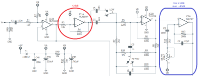

How to add some diode clipping option on Darkglass Alpha Omega circuit (Bass dual distortion) ?
eh là bas ma
I just finished building Aion's Empyrean deluxe project yesterday.
Surprised to see there aren't any diodes except a single 1n5817 for the power section.
I really like both distortions, but i'd like to try to add some toggleswitch somewhere with diodes, just out of curiosity, see how it sounds with led clipping, etc.
From what i can understand with the schematics, it looks like the gain stages for both distortions are built with five RC4559P ICs and one TL72,
but i struggle to get what are the two signal paths, and where i could connect a toggleswitch with diodes.
I suspect some extra diode clipping would be more interesting on the "raw" distortion, to make it a bit smoother.
It will be probably less useful on the first distortion, described as "punchy and tight".
Looking at the schematics, can you tell what are the two signal paths, and where would be the best location for some extra diodes ?
If i had to guess, i'd say the first distortion is made by the TL72, after R5. That would explain why it has more precision, it kind of sounds like a TL72 in its works.
Second distortion is made by five RC4559 cascading gain stages, 2 of them are also used with the last RC4559 to build the EQ at the end of the circuit.
The first RC4559 located at the beginning of the signal path is used to shape the signal before going into the gain stages, like an input buffer ?
...or maybe the first 4559 and the TL72 are just used for Hi-mid and Low switches, and boost the signal before the gain stages.
1st distortion starts at R15 and C9, 2nd starts at R21 and C15 ?
So a good spot to connect a couple of diodes would be between R29 and the Mod control (allowing to dial the balance between both distortions), before the Blend control ?
That way the diodes wouldn't impact the other distortion ?
Every observations and suggestions are welcome !

So, from my li'l rookie eye, it looks like we have a unified signal path with some basic amplification (pin 6 of IC1B is the source of the amplified clean signal for the blend later) and toggles that affect pre-clipping low and mids until we hit the IC2A, which looks like it is governing the amount of clipping gain ("drive") since there's a potentiometer going into pin two with that label.
So far, there's only one signal path. It's at the output on pin1 of IC2A that the signal splits and then is summed with the "Mod" potentiometer after IC5A/ IC3B, so it stands to reason that the clipping is happening in the RC4559s along those two paths, following either a path leading through IC3A/B, or a path leading through IC4A/B and IC5A/B. I couldn't say which is the raw and which the punchy (audio probe!). As you pointed out, it's r15/c9, r21/c15
Where exactly to put the diodes I wouldn't be the person to ask. I see a bunch of feedback loops into the ICs, so I'm pretty sure that's the source of the clipping. What is happening with IC5 I don't know--it could be a recuperation gain?
What you could do is build a two or three-diode PTP ladder and interpose the end of the legs temporarily and manually before the IC array, after the IC array, or in one of the IC feedback loops. You might have to lift a pot or component leg, but it's better than breadboarding the whole thing to me. The only thing you'd really have to watch would be the IC legs. If you bend them more than twice, they are likely to come off.

IC3a IC3b look to be buffers surrounded by tone shaping stuff... lotta buffering going on in this thing, elsewhere, too...
Not sure if you guys want to add clipping after the tone shaping ie @ IC8a (IC8b is a buffer), 'cause immediately after that is the output (which may work well to add a boost, especially if you add clipping-to-ground somewhere).
The only places I see gain being actively added (and not involved with the BMT-EQ) are:
IC2b and IC2a​
IC5a and IC5b​
IC7a and IC7b​
It would be these places I would look to add soft-clipping, because then you can also swap out a feedback resistor for evening out the gain when adding the clipping-diodes, or even add a pot to tailor the gain to taste on the fly — and so both the gain and clipping could be on a footswitch for an extra "channel".
My initial instinct is to add the clipping diodes to IC2 (breadboarded for either op-amp to see which sounds/works better — 'a' or 'b').
Oh ? so that's not the 1rst or 2nd distortion path ? IC3a and IC3b and their surrounding parts aren't gain stages ?
I thought these were the 2 distortion's channels , and the mod control pans between both paths:
Screenshot 2025-09-20 at 22-19-39 Empyrean Deluxe Distortion - Aion FX - empyrean_deluxe_docum...png
Build docs mention "the signal is split into two paths". If i'm wrong can you please help me figure out what are those 2 paths ?
Diodes to ground then! Okay, I thinking more soft-clipping.
Yeah, that would be a good place to introduce hard-clipping because you can offboard wire the B100k MOD pot and stick in a boost/recovery circuit. There's no feedback resistors in IC4, nor IC3, which is why I suggest adding a boost after the hard-clipping, though you could increase R30 if choosing the blue B path to clip.
