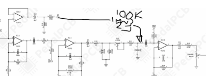

I was checking the schematic and i had this idea of adding a clean blend to this drive.
I have not even finished but this idea came after I saw the Scenario preamp schematic, although this gladio uses two tl072 to do the clean part.
I can imagine this will also work using the BP out of the informant plus a 100kb pot, but now the thing will be experimenting where is going, I mean of course the pot will have the ground, but should it be conected before the output stage?
Acording to electrosmash the output stage in the rat is before the 22n cap, the Informant keeps that area.
And the schematic is here and the worst draw ever.
I'll try and I will let you know, probably won't work because it, I mean I'm not sure, but the voltages may get crazy, but I don't know lol.
