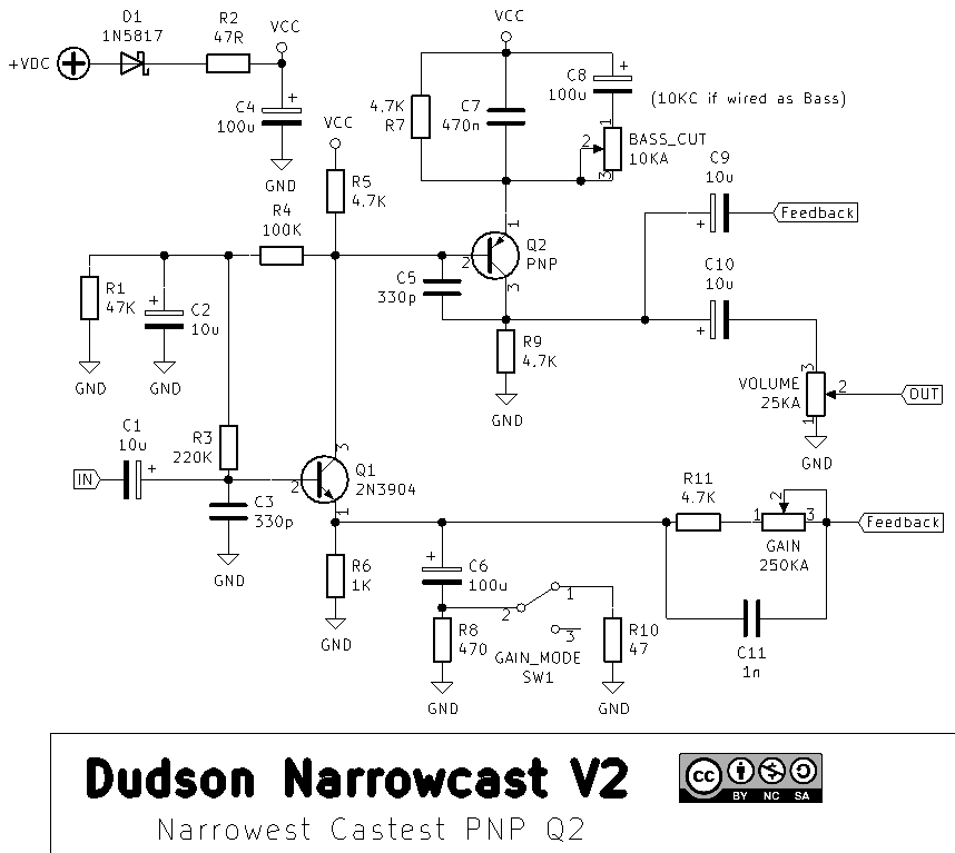

Can transistors be microphonic? I bought a batch of 50 or so Soviet PNP Ge's and was testing them out in my Simulcast, and they started screaming. It reminded me of the wah pedal seagull sound, except louder. Happened as soon as I put the transistor in the socket. The first 2 I pulled from the box both did it, even though they both tested fine and low leakage on my DCA55. Very weird!

Me too!! I've never had that happen with any ge before, but I quit building these because they wouldn't take otherwise transistors that test fine and work anywhere else. I had like a 70% success rate.
I recently built a Narrowcast. No transformer or charge pump. Was very forgiving with the Russian Ge transistors. Sounds identical to my Duocast.
