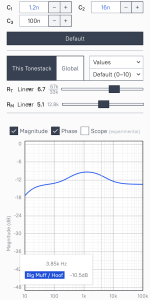

Hiya, folks! Thinking about a Dream Fuzz build. I already have an EHX Op-Amp Big Muff and I wanna do one for my DIY board (almost all DIY pedals). Has anyone experimented with a mod on the Dream Fuzz to give mids/upper mids (2k-4k) a little bit of a boost? I'd love to be able to control it, possibly thru an enclosure-mounted pot. Just need to know which resistor to replace with the pot and a good way to wire it into the PCB. Has anyone tried this and made it work? If so, wiring info? Any info helps. THANKS
If you use the hoof values , you can decrease C1 and or increase C2 to add a mid bump

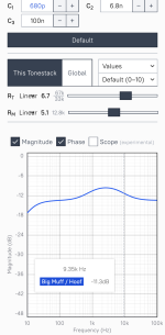

Try 820p or so for C1
Increasing C2 will add more low mids as it gets larger
Decreasing C1 adds more high mids
This works because you have overlapped the two filters
