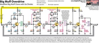

Hi everyone,
I’m building a Double G version of the Muffin Fuzz. The build docs show to populate R24 and 25 but for the life of me I can not find them on the board. There are asterisks on the build docs but there aren’t any notes that I can find to explain. Does anyone know where these go?
Found it!!
Look at the emitter on the last transistor. You'll see C15 (22uF) --> R24 (620 Ohm) ---> Ground from the emitter.
R25 (39k) from (-) on C13 (22uF)--> Vol 3.
Some of the numbering on this schematic will not match, but the schematic has the values. Link is here:

I'm gonna try to work on this build over the weekend.
I will reply here with results when I have it populated and tested.
