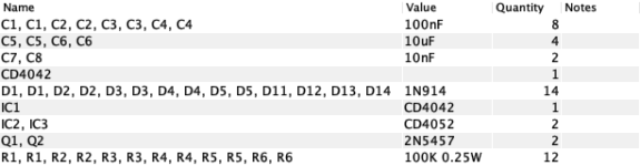

I was able to achieve solid switching action by adding a 100nF cap to each of the momentary-on switches pull-down resistors.
And a consistent boot-up default state was achieved by adding a clamping diode to one of the switches.
As for power supply, I found that this circuit works best at least +9V. Below 8 volts the logic outputs and LEDs begin to exhibit threshold operation. So, 9V seems to be ideal.
Here is the final schematic in generic format for anyone who wishes to pursue a similar solution. It can also be used for a 1-of-3 switching solution by omitting switch #4 - but leaving in tact the switch #4 pull-down & debounce cap.
