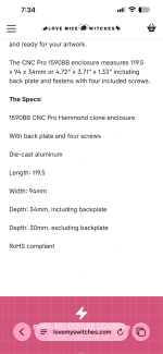

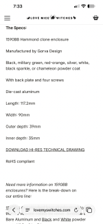

Well, this enclosure doesn’t conform to either of those exactly!
It’s 117.5mm L & 92mm W measured with calipers at the top/face of the enclosure which doesn’t fit any Gorva or Hammond enclosure in the 1590BB(X) or S90 families…
I mean, it’s fine, as long as the coordinate spacing aligns with the PCB then it’ll all work without issue regardless of a few millimeters, just a curiously anomalous, non-conforming enclosure.

The 117.5 i would expect to be the thickness of the powder coat. The 92 🤷🏻‍♂️
