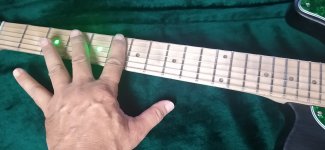

I had posted a general question in the break room thread but I have a question about possibly utilizing a snubber circuit to minimize the momentary switching noise created by the switching on and off of a series LED circuit installed under the fretboard of a partscaster build . The Anode of each LED attach to a ground wire in the floor of the fret slot. The power supply shares a common ground at the bridge . The string pressed against the fret completes ground switching circuit on. Very simple and very noisy on clean channels My Question is would a snubber circuit help to minimize the switching noise ? Any suggestion ?
