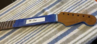

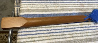

Having said all that, it’s sitting under tension right now and I’ll give it a couple weeks before the final setup. I may need to deal with a couple high frets. I can already tell this is going to be my favorite strat. The neck profile is just a skootch fuller than my red strat. I absolutely love how it feels and plays. And it actually sounds pretty darn good with the frankenstein set of pickups in it.
