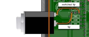

Hi,
I have build a muzzle without the sidechain jack and put a jumper between hole 1 and hole 3. But it works poorly. It darkens the tone a little and it only works with the guirar signal and not in the loop or after od. It doesnt work with louder signals than the guitar signal. Ihave a few jacks laying around. Does this jack work as a switching jack för the muzzle? and if so, how do I connect it to the pcb?

I also found this jack and it is in stereo as well with a thousand connections. Does it work for this build and how do I connect what lug to what connection on the pcb?

I don't know what else to tell you, Cybercow already pointed out the key in the lower right corner of the diagram he posted (which I've copied into the diagram below).
Right above that in Cybercow's diagram, it depicts the jack with pin numbers labelled.
The stereo SWITCHING jack will work (but not a regular stereo jack), you just use the relevant pins you need: tip 5, sleeve-switch 3, [EDIT] TIP 3, TIP-SW 5 and sleeve itself 1. Ignore the ring 2 and its associated switch pin 4. Here's PPCB's own WIKI diagram of the jack, to which I've amended the numbering.

But when you say “sleeve-switch and sleeve it self” do you mean what is labeled “switched tip” on the picture?

Sorry, I screwed up the numbering/nomenclature, I was thinking from the perspective of looking at the jack from the pins end, but I think Cybercow's diagram has it looking from the other end x-ray style... I don't know what the hell I was thinking. ANyWaY...I'll fix my post.

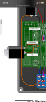

This is a gut picture of the tip/switched tip output on the pcb and the sw1 toggle. I actually don’t know which version this is if it’s the classic or smd. I ordered it as a guest (by mistake) a year ago so there is no order info nor sipping info about it and nothing on the pcb either.
Did I connect something wrong here? It works, it doesn’t work very well. It is super weak. Like on stronger signals it doesn’t clamp down at all.

Actually, I just tried it out as the first pedal in the chain and it works extremely well there. It rounds of the tone just a tad bit but its ok. But in the loop it doesn’t work well. The other muzzle I build ( a kit from musikding) works flawlessly in every use. With or without the keyjack and infeon of amp or in the loop.
So I suspect it is something with the way the jumper is wired.
You have the Classic version (THAT4301 is through-hole, not SMD). All looks good re jumper and SW1.
- If you suspect the jumper, reflow the solder on it, just heat it up with your iron and you can even add a pinch more solder on it.
- Make sure your ICs are seated well in their sockets.
- It's tedious, but double check the colour-bands on all your resistors and make sure they're what and where they're supposed to be.

Thank you for this diagram, I've had a muzzle sitting in my trouble shoot pile for close to 10 months now. And it was all because i had Switched tip and tip backwards. Once again, browsing the forums on a bathroom break solves a problem.
Thank you for this diagram, I've had a muzzle sitting in my trouble shoot pile for close to 10 months now. And it was all because i had Switched-tip and tip backwards. Once again, browsing the forums on a bathroom break solves a problem.
