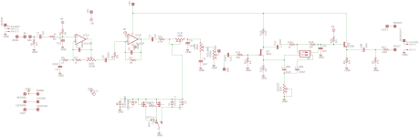

hi guys, following the amazing help by chuck d bones and liani on the chrome dome tone conundrum, thought id see if anyone had any tips about an idea id like to get done,
im trying to put a timmy clone, and a xotic ep booster clone onto one pcb. with a 3pdt switch to change the order. so overdrive into booster, or, booster into overdrive.
i got a prototype done, but its hella noisy! i guess as could be expected! all works "as it should" but im just having a problem with controlling the masout of gain when the order is changed. i think my switching is correct on the 3pdt, but anyone have any ideas to tame this down abit, as past 12 o'clock on the gain control its feeding back and oscillating like crazy.
so far ive tried changing the pot values of gain, volume and boost to try to tame it down, but with no success. surely if these two were seperate store bought pedals they wouldn't be so unusable once controls started to get turned up?!
any ideas would be amazing, as the timmy sounds soooo good! cheers, hope your all well. angry exotic.png

Here’s a few thoughts / questions. These probably won’t address the noise problems you’re describing. Although it still sounds like you might have a wiring error.
I’m not sure what that schematic is, is it yours or something your referencing? I’m assuming reference because it’s obviously not a Timmy circuit... just not sure why you included it without describing what it is (unless I’m missing something obvious).
the original ep booster circuit (like how it’s drawn there) always had a volume increase even with the knob turned down. The newer version replaced the bass dip switch with a -3db switch so you could access unity volume if desired. If you added a master volume (external or trimmer) to the boost side, it might help you not overload the overdrive as much when the booster is first.
even with the bass dip switch not activated (10uF cap activated, not 100uF), the EP circuit has a bassy sound. Something to do with the phase shift of the jfet reinforcing bass frequencies (I guess, from things I’ve read). Anyway, for me the bassy sound is not ideal when boosting into overdrive, but I really like it at the end of the chain. I would make the switch external, and use 10uF for one side and 1uF for the other (1uF being a bass cut mode for nicer boosting into the OD). Or, hardwire The 1uF, and put the 10uF in series with a ‘bass’ pot. Just some thoughts to experiment with.

sorry, your right, the overdrive is actually taken from madbeans turnabout, which in turn is inspired by jhs andy timmons, or angry charlie.
there's an episode of that pedal show, where they are testing overdrives with boosts, before and after, and right at the end, they test the ep booster with a jhs angry charlie. it sounds amazing! so i kind of want to put both into one enclosure with the ability to switch the order.
ok i didn't know you could get an ep booster that offered unity! that's great news. however, i do take on your comments about the bassyness of the xotic. im thinking about maybe trying to switch it out for say the arrows booster circuit idea from EQD. that way i know i can easily set unity level, so as to not affect the gain so much when i switch effects order.... i think...
but actually, then things will be easy, kinda fancy a challenge! so, ill take your tips of changing up the 10uf/100uf and give that a go, and also stick a master volume trim pot on the end of the ep booster section, see if i can get them to play happly with that!how do you think they were using the dip switch to get a -3db?

I wouldn’t recommend this. You may introduce distortion. You also may have to change other components to properly bias the jfet. Of course you could try it and report back what you find out, maybe it’ll work out. But, a simpler method would be to stick a 50k trimmer at the end of the ep circuit, wired like a volume pot. Set it for unity volume (or whatever you want) with the boost pot at minimum.

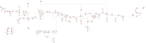

yep, pretty much as soon as i typed that i knew id have somethings to change! ive got the voltage bias from the tl072 to try it out, but im going to stick a little trim pot to ground after the ep section, try that first as its easiest!

ok, added the trim pot and changed up the values of the bass caps, anyone have any other ideas to try before i order the pcbs?! charlie.png
