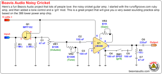

One of the ideas I've been thinking about is building a small solid-state practice amp. I like the Noisy Cricket project at Beavis Audio Research. But it got me wondering about whether or not I could use a PPPCB board in place of the preamp section of the circuit. I really like how the Vertex Steel String Clean Drive sounds, and have a Six String Stinger board in the pipeline. Would it work to run the SSS board into pin 2 of the LM386 and then just have the rest of the Noisy Cricket circuit after that? Are there any other boards available here that might be suited for that kind of application?
