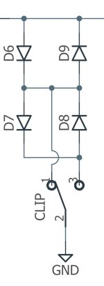

What does this jumper between clipping paths do?
DDad
Member
In the Mojito Deluxe there is a connection (in yellow below) between clipping paths on an op-amp gain stage. What does that do? Any clipping I have seen that has multiple diodes does not have that. Mojito Deluxe schematic I will eventually breadboard it to find out, but holding off on ordering parts right now.
