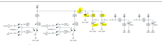

I don't know here is the good place to discuss but let me know if I need to move the post. My question is 9vdc filtering. I am checking different Analogman King of Tone, Prince of Tone schematics and I see some differences to handle 9vdc but I couldn't understand why. Could you please help me to clarify why they are different and is it very important to add extra components to filter 9vdc in those ways as below?
Here is The Pauper (Prince of Tone) and Paragon Mini (King of Tone without charge pump) 9V dc Filtering:
Here are another schematics (Aion Fx) which there are 100R and 100n as extras for same type of pedals:
