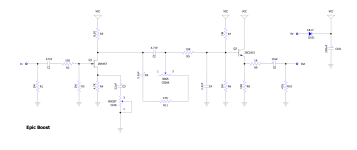

I like the idea of the Arche boost - two knobs; bass and level. Once you have tamed the highs they work well. I ended up modding the Xotic EP Boost circuit to have just those two controls - it's a simpler circuit and I like the sound even more. :)
Nice! I’d like to know about that mod. Is it the fat switch? Episode is in my list now.
I'm looking at my schematic now, comparing it with the EP Boost... Not sure how easy my version would be to build on the PCB. I did away with all the switches and the charge pump. Added a bass control between the transistors - possibly could be done but it would be a mess!
