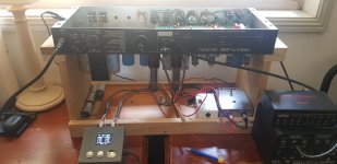

I'm working on building an updated version of the dual bias meter, and adding some additional features (powering the unit from the heater pins, for example). I've updated the code to work on the latest version of the libraries, modified the source from .ino to .cpp, created a PlatformIo project for it, added support for SSD1306/1309 displays, updated the font, and added documentation. It's all on the GitHub repo:
I've got a couple open discussion topics right now for potential enhancements.
Right now I'm working on an enclosure for building it on an AirCookie prototype board, and am considering making a PCB in KiCad. I'm also working on a PCB for the probes that would fit a rectifier for powering it using 5VDC. I'll be sharing those files on GitHub when I'm done designing them.
@shampeon I have to check it out, I've also updated the code as well over the past few months, also made a pcb board and updated the 3D printed enclosure for 3 buttons and screen (1.44/1.8 Inch SPI TFT LCD Full Color Display Module ST7789 OLED Screen) .. I've been using it the past few months with several of my tube amps ( Fender 30, Fender Prosonic (Head and Combo), Laney Aor Pro tube 50, Fender 68 Custom Pro Reverb). Latest update I did was to be able to set the Voltage Scale and Resistor for the 2 probes to be more accurate. here's the list of some the improvements I did below

I'll add some more photo's to see the UI
If you're interested in checking out my version I put it up on github.
