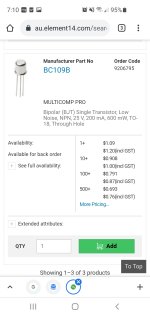

Hi all,
I'm starting to stockpile components for current and future builds and the Powersound Overdrive is one of them. I am able to find BC109's but im not sure if these come in different values. The ones I have found are rated 25v 200ma 600mw. Will these be ok? I have attached screen shots. There are BC109B's which are rated the same by the looks of it.

The ones with letters after are the gain range, the lowest being A mid gain is B and C gain is highest, with no letter it's a crap shoot what gain range you'll get
Thanks Barry. I always like a bit more gain on tap so BC109B's should be the ones. Appreciate you helping me out mate 👌
Just to be clear, it's not a circuit I'm familiar with, depending on how they're used in the circuit gain may not matter, but when it does that's the low down
