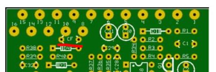

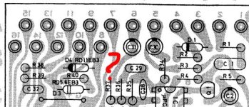

Boss DM-2 what resistor sizes needed?
geso
Member
I want to make a Boss DM-2 on a PCB near to the size of the original. What size of resistors did they build into the original pedal? Was it 1/4W or 1/8W? I want to make sure I won't run out of space before starting to build. Moreover from 1% tolerance resistors I only have 1/2W type, I guess those might be too big for this purpose.
The Amethiyst Delay is a "reiterpretation" of the old pedal so to say. It has a detailed building instructions pdf but that also seem to lack that info. Meanwhile I checked that 1/4 may not fit to be oriented horizontally, but according to photos of the original board, several resistors are aligned diagonally there as well. So maybe I will stick to 1/4. Sideways there seems to be enough room for those too.
