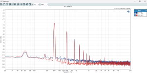

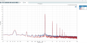

Hello everyone! This was one I finished awhile back but decided to revisit and run some analysis on with an Audio Precision 555.
Unagi Transformer Equipped Unit: Measured @ 600R Zin
Noise of output: (EQ @ noon)
1/4":
Volume Off: -44.174dB
Volume Max: -24dB
DI:
Volume Off: -43.5dB
Volume Max: -44.243dB
Maximum output before clip (roughly 10% THD)
1/4": +5.332dBu
DI: +5.5dBu
SNR:
1/4": 52dB
DI: 49dB
Lowest THD before Clip: +2dBU Output knob @ Noon
FFT DI @
300Hz
1Khz
