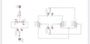

Can anyone see any issues with this schematic?
JamieJ
This basically the Sandspur schematic with the input cap on a switch with 1u and 47n, the 470r on a switch with a 1k plus a switch to choose between two bias pots. One would be a trimmer. Then before the output volume pot I have added a AMZ tone control with mids and volume recovery by a LPB circuit.
Can you see any issues here that I have messed up with?
It is a LED indicator to show a change of bias pot combined with SW2&3. That would be a 3pdt.
OK, you asked...
Other than being a tangled mess? If you untangle the wires, it will be much easier to read and much easier to see the redundancies in the switching.
Just to be clear, SW2, SW3 & SW4 are ganged together? If so, you don't need both SW2 & SW3, one will suffice for selecting a bias pot.
Same goes for the two parts of SW5, you can use a single pole for selecting R3 or R23. What is the purpose of SW5? Is it a volume boost?
Why two VOL pots?
You might need to fiddle the biasing of Q3 to maximize headroom. But then, you really don't need Q3, at least you don't need any gain recovery. There is a HUGE signal at Q2's collector, but you divide it way down with R3, R23 and the bias pots. If you rearrange R3, R23 and the bias pots, you won't need Q3, or you can make Q3 an emitter follower.
Thanks for the rinsing Chuck 🤣
It’s my first attempt at drawing up a schematic. Thank your for you comments.
I based it on the two schematics pictured from FuzzDog.
Yep - SW5 is a boost. I thought it would get too much of a volume drop from adding just a tone control so I wanted it to have a boost afterwards.
I have built this with the PCBs but it was a nightmare to wire so I wanted to see if I could make a PCB. All a nice and steep learning curve which is great.

DANG!

I've checked my Schematics 101 doc and boiled it down to the following, in hopes it helps JamieJ and anyone else starting out drawing schematics. Take it with a grain of salt, there are many ways to skin a schematic and everyone develops their own druthers.
The following ideas are mainly from Olin Lanthrop, but a few others added, that I've gleebed from the net and condensed whilst trying to better fathom the art of the schematic myself:

Look back and you can see the point of all these rules is to make it as easy as possible for someone else to understand the circuit from the schematic, and to maximize the chance that understanding is correct.
• Good schematics show you the circuit. Bad schematics make you decipher them.

I often see "+" connected intersections in pedal schematics as opposed to "T". Not a big deal to me if I can see the connection easily. Some people loose their poopy if they see an arc where lines cross (see schematic below), doesn't bother me.
What I've learned is mainly that everyone who draws a schematic has their own way of doing it.
Here's one way to draw a simple two transistor fuzz, for instance:
REALLY? I'd rather look at a sloppy hand-drawn schematic that follows L-R & top-to-bottom flow (inputs left, outputs right) than burn my retinas with the above... At first glance it is legible and clear but... Has the person who drew it ever seen another schematic? A lot of what I've learned is just from looking at LOTS of schematics — most have a standard orientation and flow, and as a budding circuit builder I copy the common standard practices of what I see.

Well done!
When I would prepare Design Review materials, I always strove to present a clear story that lead the reviewers to the conclusion that I knew what I was doing and the design was solid. If I made the reviewers work too hard to reach that conclusion, my reward was action items.
