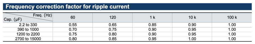

Actually, good electrolytic caps will have 2 different specifications, for maximum DC voltage and max AC voltage.
Edit: Ack, I'm wrong here, see below...
Right, if the don't have separate specs for max DC and max AC, look for text like this (from a Panasonic cap spec sheet):
The sum of DC and ripple peak voltage shall not exceed the rated working voltage​
and then they provide a frequency correction for the ripple (ac) voltage:
1756770765589.png ​
Edit:
Ack, this is true, but it still doesn't address @aquataur's question regarding AC coupling when Vdc ~ 0.
That's really cool Darwin! How do you apply the correction factor? For example in this circuit, if C19 was 2.2uf (so I can follow from the table)
Actually, I may have goofed and gotten over my skis on this - let me do some refreshing on this tomorrow and report back.
And people who know this better can pipe in and answer (and correct my goofs).
But it is quite common to see electrolytics in use w/ close to ~0 Vdc across them, and yet passing AC signals.
So let me clean out some mental cobwebs and come back.
Edited.
