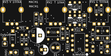

One more module for now. This is a pre-boost distortion module that can implement Bobby, Cetus or John from PedalPCB. I used DIP-8 for the op amps on this one to try out alternates. I like 4580 in distortion pedals instead of TL072.
At PCBWay
Interactive BOM
When there are three values shown for a component, it's for Bobby/Cetus/John (Sheriff/Kraken/Jack).
