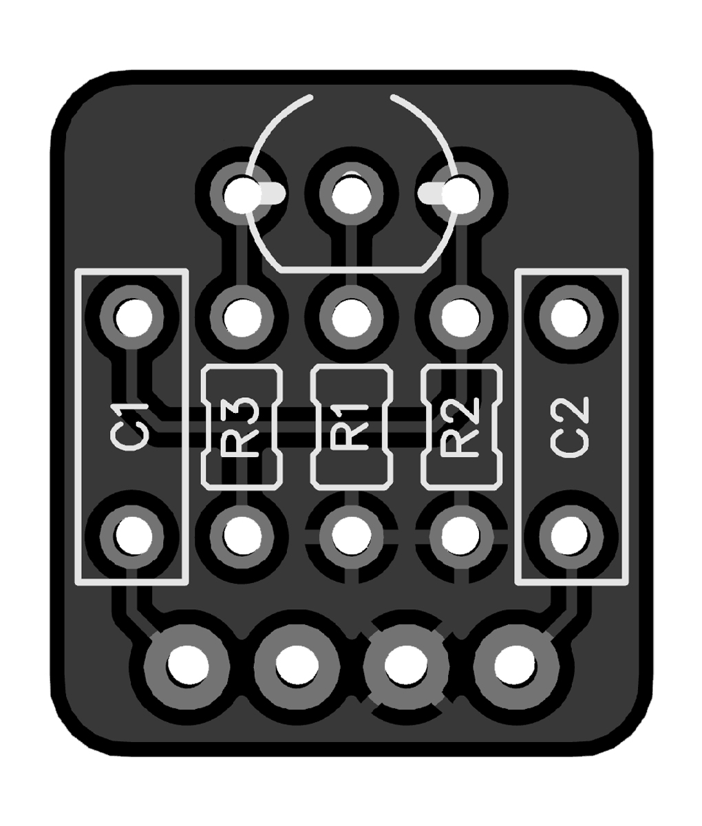

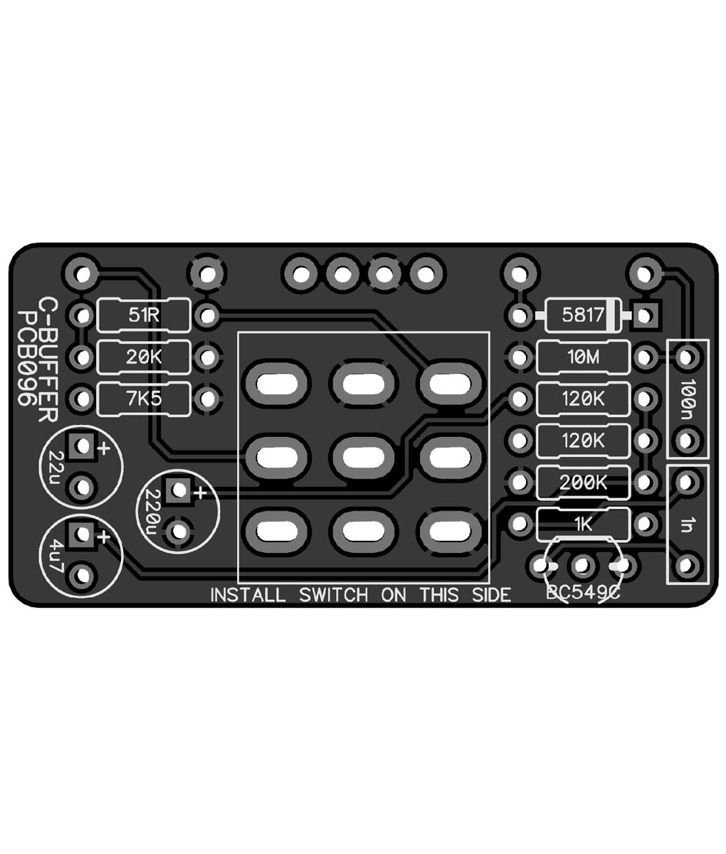

Not unity gain. But might not matter if close enough? If you turn the volume all the way down, does everything work that way you want? If so, good enough. Alternatively, a tiny jfet or BJT (source or emitter follower) buffer would be very easy to add in the bypass path. I think I've seen little boards that mount on the footswitch that have the buffer on them already.
