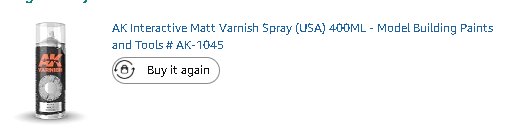

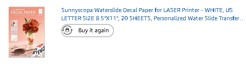

Thanks - I used the clear Sunnyscopa laserjet waterslide decal paper (not film-free, not white backing). I'm going to try the film-free next. To get the color on the lettering of the Paisley Drive to reproduce properly, I painted that area of the enclosure white before applying the clear decal over it so that the lettering is laying over a white backing.

I was thinking about also trying the waterslide laser white, but after seeing your results I may just try the clear.
Also, I am considering getting the film-free white (laminated one). There are a few pedals I want to make and they all seem to be black or really dark..
