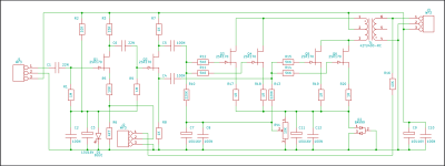

Ever try a JFET power amp?
I was aware of the technology, but have not investigated it. A quick scan of the datasheet tells me that these are intended for power conversion applications where they are used as switches. They can be operated in linear mode and the gain (transconductance) is HUGE. Orders of magnitude higher than a vacuum tube or the typical small-signal JFET. The capacitance is quite high as well, which means a linear power amp circuit will need to have much lower impedances than a tube amp to achieve the same freq response. Intriguing.

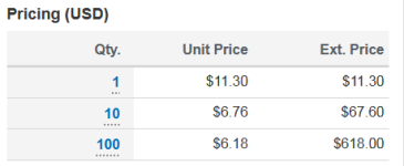

This is the pricing at Mouser.
