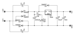

How are you powering yours? Battery or external power supply?
I built the Aion Vulcan and it does not oscillate.
I'm using a power supply with transformer and regulator that I made, using this scheme.
Interesting that the Vulcan scheme did not oscilate, perhaps reducing the electrolytics could make a difference, I will test it!
The transistors used are 2n5088.
Thank you very much!
