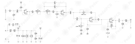

Hey folks, noob here. I'm about to build a Frequency Interchange Filter pedal for some sound design projects and I was curious about changing the value range on the high pass filter. If I wanted to extend the cutoff range (from 190Hz- to say somewhere around 1kHz), how should I go about doing this? Would changing C6 from 56n to a 10n cap accomplish this or have I (very likely) overlooked/misunderstood something? Thanks for the help! FrequencyInterchange-PedalPCBschematic.jpg
Thank you! If I want to get in Tube Screamer HPF territory with a max cut off feq of around 720Hz, it would be enough to change C5+C6 to 15nF right? I find HPFs somewhat confusing, sorry 😅
Edit: mixed up something
So chinless, the way I understand this we have to change C5 and C6 for 10nF (or 15nF in my case). But I am not sure here like I said, did you figure it out?
