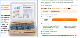

Thanks for the replies, that is really helpful information. I've been browsing around for components and tools. Bundles of components similar to this seem like an economical and quick way to build up my components on hand for common items. Is there a reason to avoid these? This is on Temu
I’d recommend just buying components you actually need for a project. For cheap components like resistors I’ll round up the totals so I have a few extras on hand.
If you’re interested in extra parts for breadboarding, just print out or save the BOMs for those too, and combine those with your pcb BOMs for ordering.
There’s also a benefit to standardizing your component sourcing. It’s harder to visually verify all your resistor values on a board that’s not working right if they’re different sizes and colors. Face them all the same direction while you’re at it.
Trying to get cheap assortments and stock every value you could potentially need doesn’t really work. There’s always going to be something you don’t have, which means every pcb requires an order anyway, and trying to not buy things you already have means you need to take inventory of your stock before every order which will take longer than just check-listing through the BOM and ordering all the parts.
Just doing it the hard way is actually the secret shortcut.
