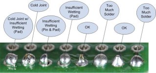

Have you triple checked all of your solder joints? Check this image to make sure you only have the ok solder joints. They should kinda look like Hershey kisses. Also, check out this page for how to address the types bad solder joints and what can cause them.
Also, always post clear photos of your pcb and wiring. If you don't, we can't address your issue.

Many thanks for the reply. Yes I’ve checked everything, and it is working, but not to the extent that it should. It needs a higher degree of sensitivity for the LED’s to fire.
