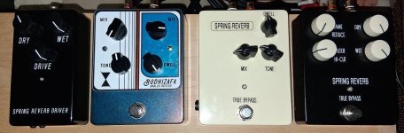

125B/1590N1 for an external tank. No stomp switch though, always-on style. Lots of other quirks. I've been building them repeatedly for years, although I feel like they're all just prototypes.
Far left in this pic is the last one I finished, it goes with a specific tank I have.
Dude…get your designs out there don’t think just because you made it nobody would want them. Make some demos or something. I think the second from the left LOOKS the coolest.
Second from the left is the Bodhizafa from @jubal81 ; of course it looks the coolest :). There's a thread for it, it's what I would recommend people build. On the right are the two Ricochet pedals. Only the 125B on the left is my design, but I have like 5 more basically the same packed away.
Sizes left to right are 125B (Tayda), 1590BBS (Stompbox Parts), 1590BB2 (Tayda), and 1590BB (Amplified Parts). It's hard to tell scale from a phone pic but they're all pretty much different heights. BBS is slightly taller.
