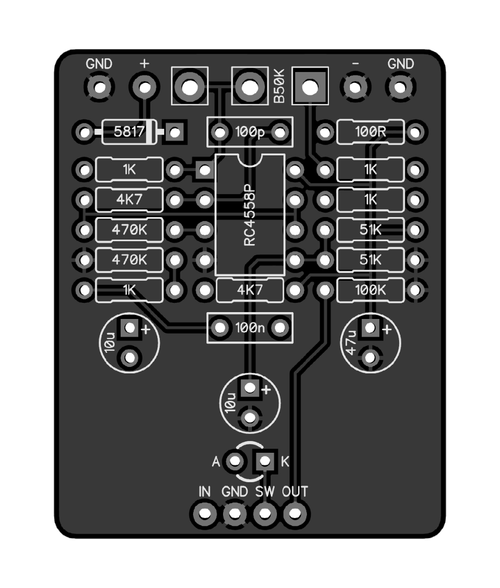

The breakout board is a fixed boost (it's adjustable internally, but intended to be set-and-forget) so if you go that route you'll want to leave the Equinox volume pot intact.
It is designed specifically for this task but I hate to play salesman (despite my shameless use of the "set it and forget it" catchphrase) so I didn't mention it.

That's what I thought. "Why didn't @Robert mention the Breakout Board With Output Boost?"
And no sooner had I thought that I realised two things:
1) Robert's modest and doesn't like to sound like a shill for his own stuff (so I stepped in);
and
2) Robert was embarrassed that he hadn't come up with a catchier name than "3PDT Breakout Board with Output Boost"
I get it though. He comes up with all those catchy names for other circuits, and just wants a rest, needs to take a break, and call the utility boards what they are. I mean, if I were looking for a 3PDT Breakout Board with Output Boost, I wouldn't necessarily type "BLACKBIRD AFTERBURNER BYPASS" into the search engine, it just wouldn't occur to me.
