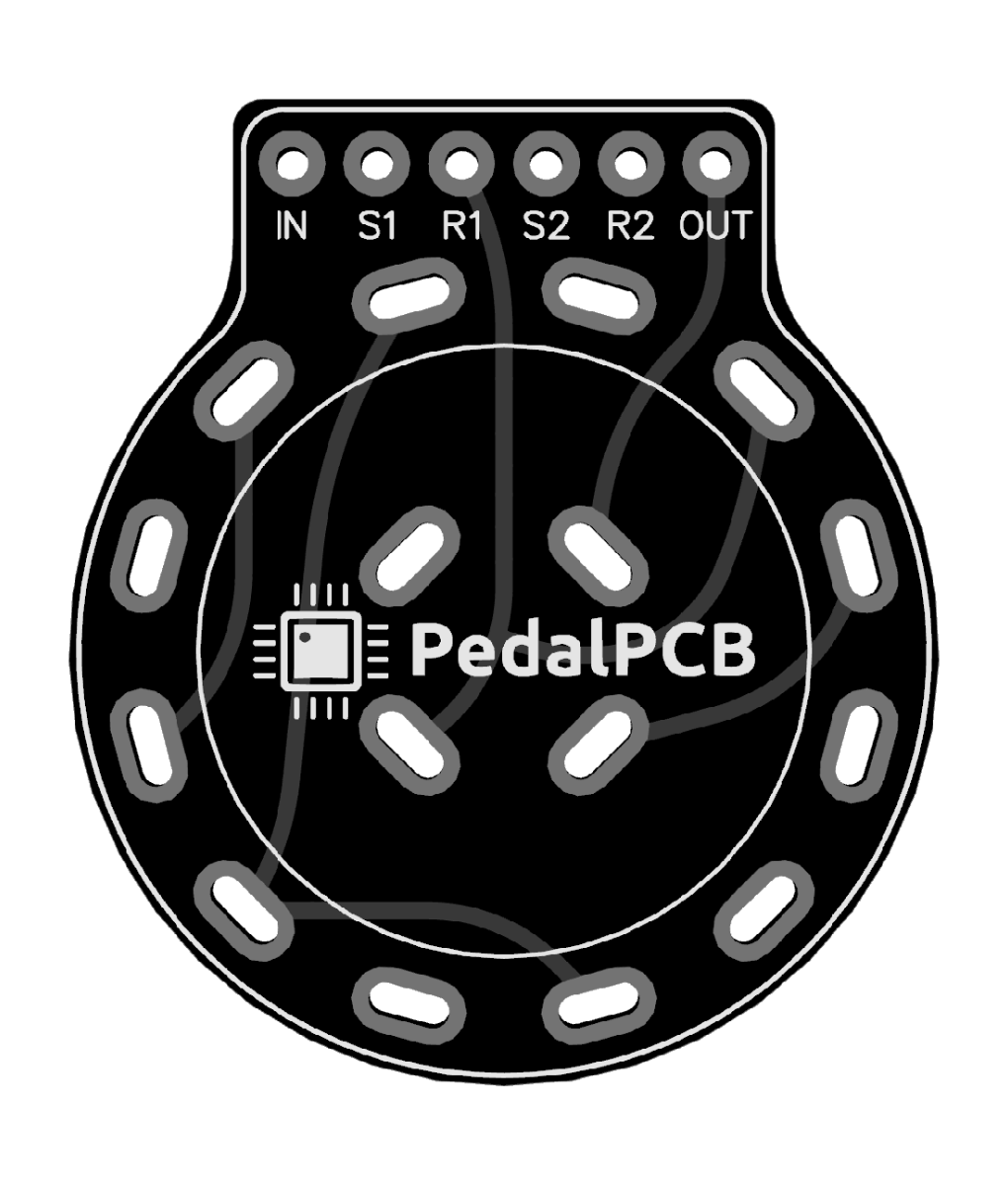

I built a big muff clone (BYOC Large Beaver) years ago and would like to wire it up to a Muroidea build in one box. I’d like to have one input and one output, have both pedals be independently selectable, and have a toggle switch to change order (rat->muff, or muff->rat).
Any guidance on doing this? Thanks!
You can hand-wire the order switch, or you can use a breakout board.
Here's the overall wiring diagram using breakout boards:
You can, of course, hand wire the entire thing if you'd prefer to not use breakout boards.
Thanks, very helpful. The BYOC board numbers their footswitch connectors (2, 1, 5, 4, 7, 8). Any ideas on that numbering and how it would equate to the breakout boards above?

That numbering on the BYOC PCB corresponds to what lug of the 3PDT it attaches to:
1 • 4 • 7
2 • 5 • 8
3 • 6 • 9
From L to R on your PCB, I think it should be…
2: Ground/-
1: LED Cathode/-
5: Board In
4: Jack In
7: Board Out
8: Jack Out
