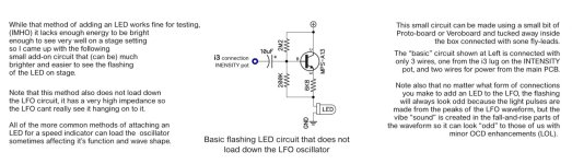

How to add bicolour LED to a two-speed Forum Vibe?
Hello. First time posting here. I can't find info on this that I can understand. So I have built a Forum Vibe with two speed pots and a 3PDT switch to switch between the two pots. I want to add a bicolor LED that will indicate both LFO speed and change colour depending on which speed pot is "on". Can anyone help?
General context: I've built a few pedals but my electrical knowledge is limited and I can't really read schematics...
How do I figure out if I need common anode or common cathode? It appears I have used a common cathode LED, so presumably I need a common anode one? But also, what do I have to do to get it to flash with the LFO speed?
It's determined by where the LED gets its power and the easiest way to implement a switch
If you want it to flash with the LFO then you are probably going to want to use a common anode LED so both colors will get their signal from the LFO, then you can install the CLR's on each neg lead and wire those into the foot switches
I haven't looked at the schematic—so I'm not sure if you need all the poles on the 3P2T switch to go from 1 pot to the other. (I'd think if the pots get a ground to one of their terminals, that wouldn't need to be switched, it could be left on . But If this is wrong, and you actually need all the poles, then you will want to get a 4P2T switch.
Looking at the schematic, nothing on the pot(s) are going to ground — However! ...
The dual-ganger SPEED is wired as a rheostat (both gangs), not a voltage divider.
Need two poles for each input to GangA-3 lug & GangB3 lug, but the outputs are all going to the same stream ie lugs GangA2&1 and GangB2&1 are all tied together.
3PDT should be doable.
