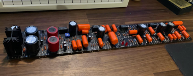

I built my first pedal around Christmas time and I haven't been able to stop building things since. I hope this is ok to post here. A slightly more ambitious project this time.
The board is a Wizard MTL from HeadFirst in Australia. Jason's board was fantastic to work with
I sourced all of the onboard components from Mouser and Amplified parts for the rest.
Currently waiting on my Chassis, Headshell, and Transformers from Nik @ Ceriatone.
Doing 2xE34L or KT77 50 Watt.
Adding a Zero Loss FX loop and Midi
I can't wait to get back at this.
