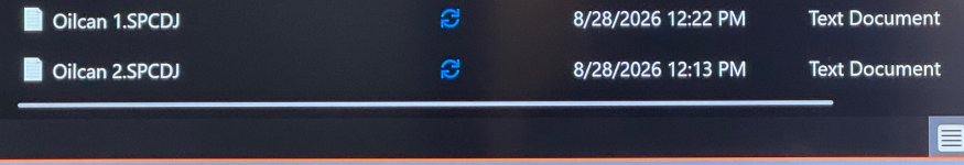

In search of Stereo Reverbs and Delays to fill 2 Binaura EEPROMS.
Here are the first two renditions of a shot at the Oil Can delay - "D01 Stereo Oil Can Delay.spcdj" and "D01 Stereo Oil Can Delay 02.spcdj". Because the new native SpinCAD file save format is a JSON file, it can be presented as text in code wrap. You should be able to just copy the code in its entirety, paste it into a fresh/empty TEXT file, then save that file as "xxxxxx.SPCDJ". SpinCAD can then open it directly with an "Open Patch" command.
This is my first time sharing a SpinCAD patch this way. Please let me know if it works.
D01 Stereo Oil Can Delay.spcdj :
